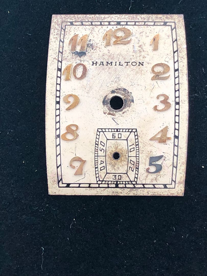

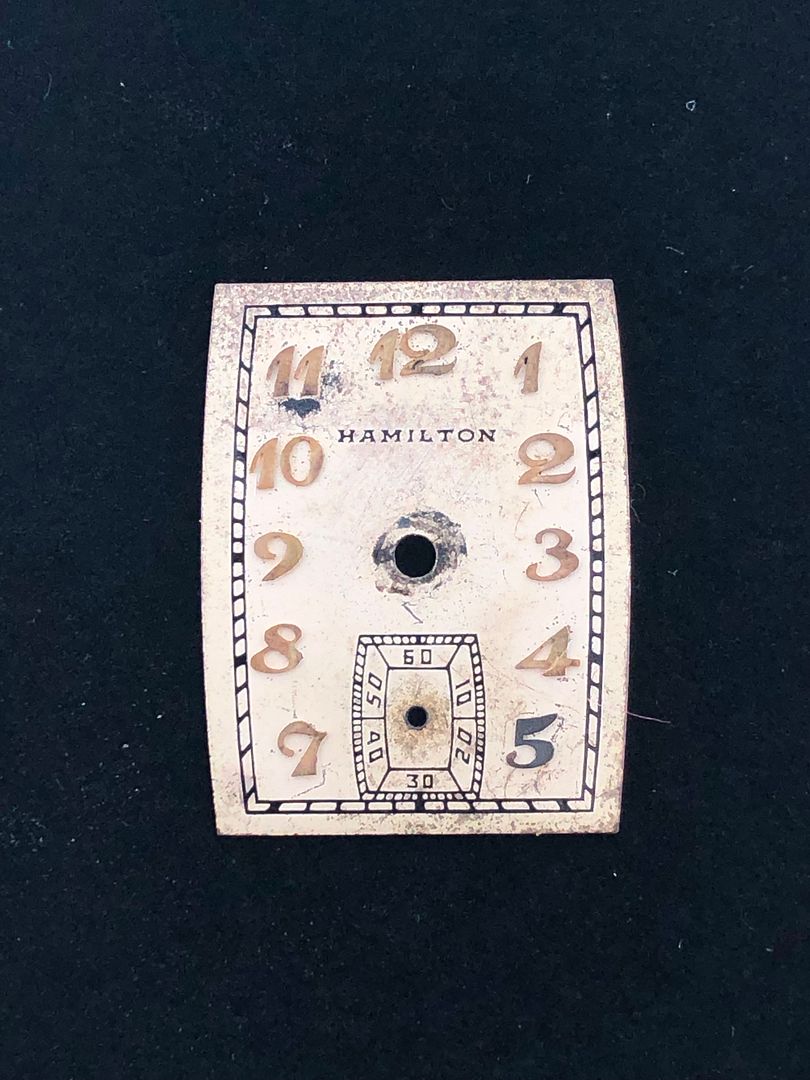

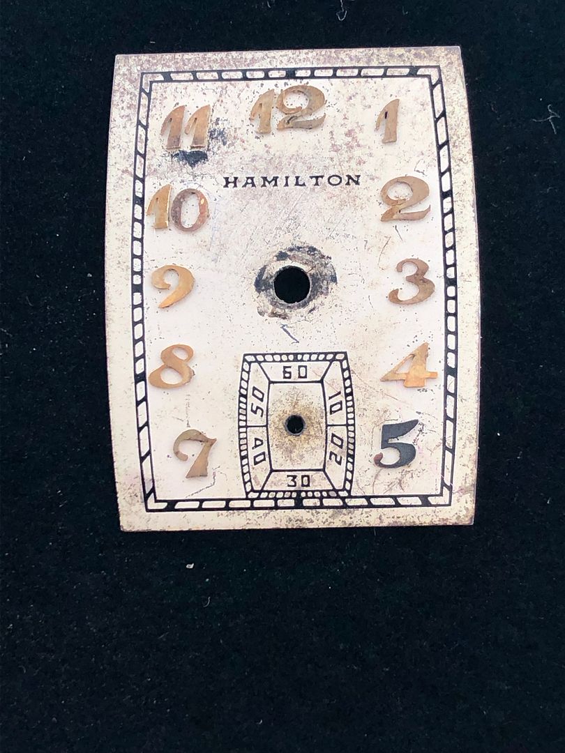

#8 Post by Nookster » Sun Feb 10, 2019 5:27 pm
Here is a Custer dial.
Photos 1&2 0's reversed and you can see the problem.
3rd photo is of the 2's swapped, they look the same to me.
The 0 normal
The 0 turned around
2's switched

#9 Post by QuartzCrisis » Mon Feb 11, 2019 10:25 am
Thank you, Nookster! You've solved the mystery. Great pictures!
